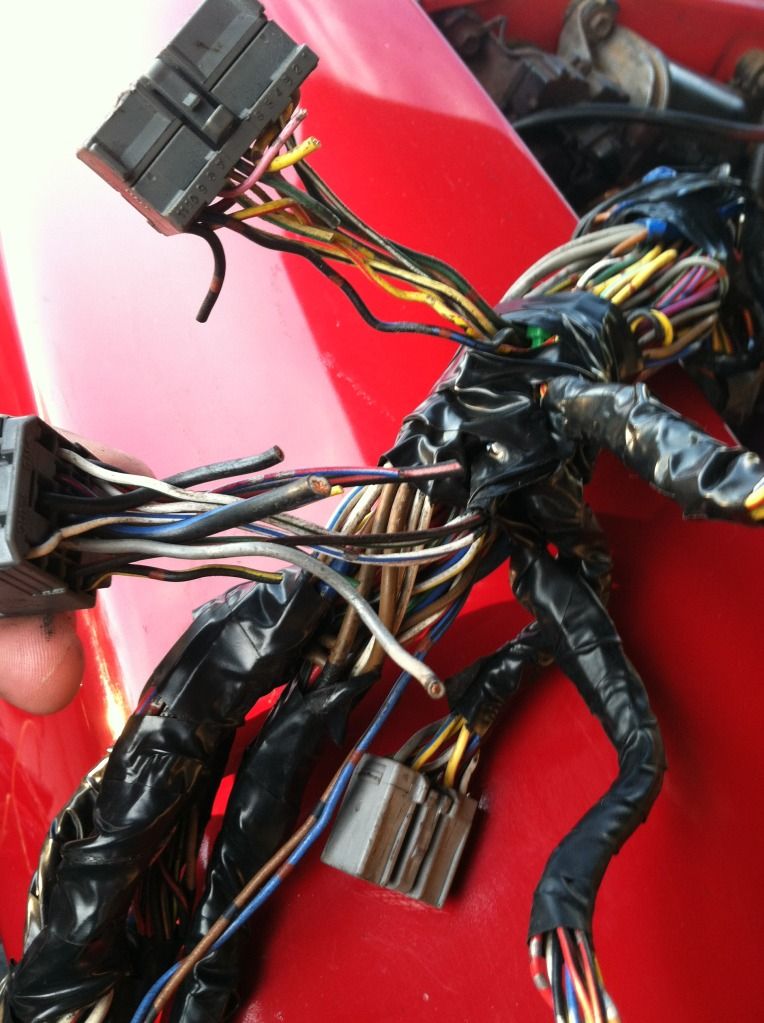

Found out what the issue was. The harness is hacked up though the seller told me it was uncut and pulled from a running car. The IH1 was jacked up bad. the hacked wires were hidden behind electrical tape.
here's the pic of the IH1 plug harness side
you can is the pic clearly the starter signal wire, FP relay and resister wire, COR wire IGN switch etc are all cut and the wires are completely missing. so it's not an easy fix of connecting the the cut wires... the wires are completely missing. sending the harness back and going to find another one. just sucks this guy wasted my time.
